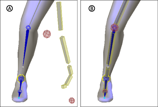

A character’s leg between keyframes A. Align Control Rig is disabled. B. Align Control rig is active.
Displaying the two systems forced together gives you a more intuitive way to manipulate the rig, as it replicates direct manipulation of the bones of the character. The IK and FK elements can still be manipulated individually, are solved differently, and have different function curves, but you can manipulate them and their children while previewing the final solving.
By default, the Align Control rig option is activated when you create a Control rig. If you need to view the solving of the IK and FK systems individually in order to fine-tune your animation, disable the Align Control rig option.
