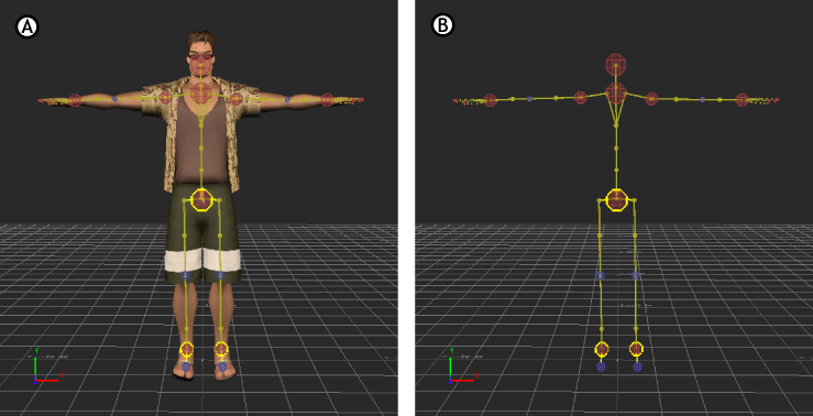

A Control rig is a character manipulation tool that lets you change the position and orientation of a character to create or alter animation. You can only create Control rigs for characters that are characterized.
A. Character with Control rig B. Control rig
Control rigs are equipped with kinematic tools that let you control the skeleton of a character intuitively and automatically achieve smooth and predictable results over the entire body. They provide body part pinning, automatic floor contact, and three different keying modes. All these elements help you achieve quick, high-level manipulation of a complex structure.
