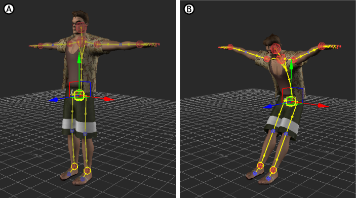

When you are manipulating a character with a Control rig, you can pin down the effectors to restrict body movement and influence how other joints behave relative to the pinned effector. This lets you selectively manipulate parts of your character without affecting the entire hierarchy.
Effector pinning A. Character with wrists and ankles pinned in translation and rotation B. The wrists and ankles remain in place even when the Hips are translated along the Z-axis.
When you create a biped Control rig, IK effectors on the character’s feet are pinned in translation and rotation by default. On a quadruped Control rig, the feet are pinned in both translation and rotation.
