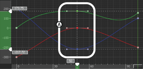

A Flat key is a keyframe with flat tangents and Fixed interpolation. In the FCurves window, you can see that a keyframe’s tangents are flat when its tangent handles are horizontal.
If your character’s feet go through the floor, setting a Flat keyframe at that point prevents the slope of the original animation from overshooting or undershooting.
Flat keyframe A. Keyframes with flat tangent handles
See Flat button for more information.

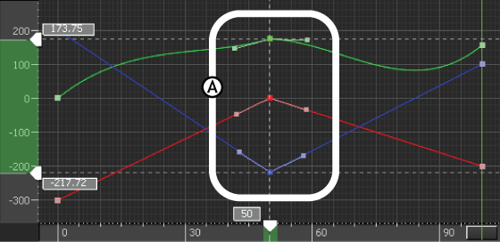

A Discontinuity key is a keyframe with discontinuous tangents and Auto interpolation. A discontinuous tangent points directly towards or away from the next or previous keyframe.
Discontinuity keyframe A. Discontinuity button B. Keyframes with discontinuous tangent handles
See Discontinuity button for more information.
