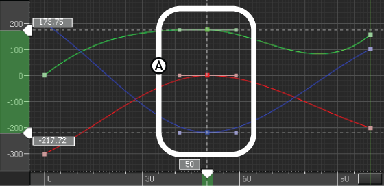

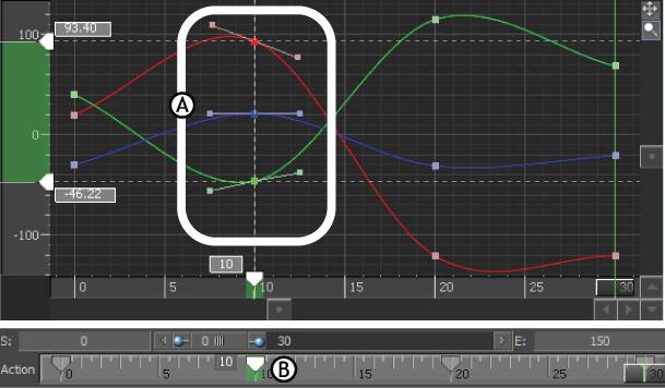

For example, setting a keyframe on a selected cube with “T” as the Keying Group adds a keyframe to the object’s X, Y, and Z translation curves. If you delete any keyframes in the FCurves window, the remaining keys are still represented by visual keyframes.
A. Keyframes added to the selected object’s X, Y, and Z translation curves in the FCurves window B. A visual keyframe representing the three keys in the Transport Controls

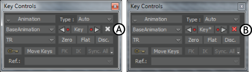

The Delete button removes the keyframe at the current timecode for the selected object, function curve, and property.
For example, if the selected object has a keyframe for the Scale property’s X value at the current timecode, clicking Delete with Translation as the Keying Group deletes a keyframe from the selected object’s Translation curve. The keyframe for the Scale property’s X value is left untouched.
When there is keyframe animation in a scene but not at the current timecode, Delete is unavailable. If the selected object does not contain a keyframe for the selected curve and property, Delete does nothing.
Keyframe buttons A. Delete button not available B. Delete button available

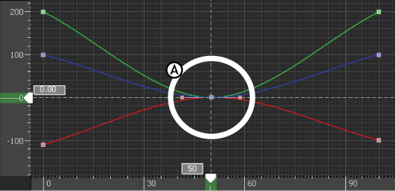

Clicking the Zero button sets a keyframe with a zero value and flat tangents for the selected properties.
FCurves pane A. A Zero keyframe with flat tangents

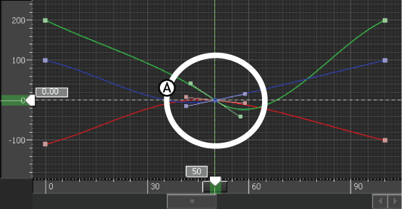

Right-clicking the Zero button sets a keyframe with a zero value for selected properties, but the tangent is not flattened.
FCurves pane A. Right-click the Zero button to set keyframes with a value of 0 and tangents that are not flat.
