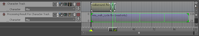

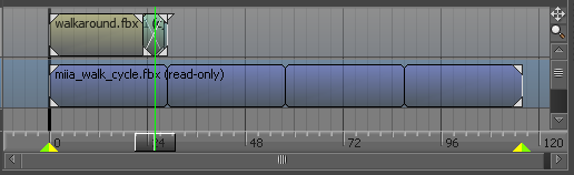

mia_walk_cycle.fbx clip stretched to frame 116
The clip loops four times.
Character Track context menu
The time range is resized to fit the length of the clip, as shown in the following figure.
Character Track shown muted
to go to the beginning of the track and then click Play (
), or go to the Action timeline and drag the Timeline indicator (
) to scrub through the animation. Mia walks smoothly for 116 frames.
