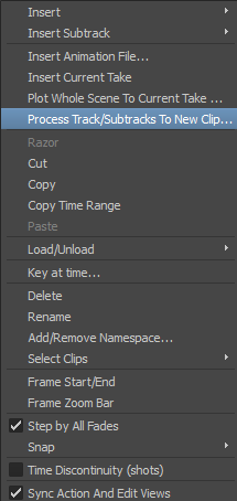

In the following procedure, you process the two clips to save them as a single result clip.
To process the two clips:

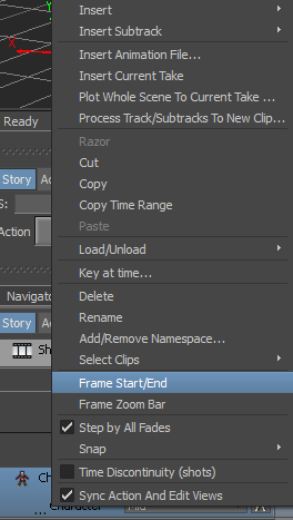

Character Track context menu
The time range is resized to fit the length of the clips, as shown in the following figure.

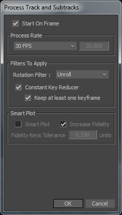

The Process Tracks and Subtracks dialog displays.

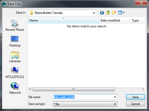

In the Story window, a second Character Track (Processing Result for Character Track) appears containing the new mia_walk_cycle.fbx clip.
