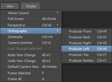

- In the Viewer window, click the View menu.
View menu options
The View menu contains options that define how you view your scene. You can choose the number of camera views, switch camera views, add cameras, and access other options related to viewing the scene.
- Choose Orthographic
Producer Left.

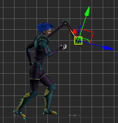

To modify the animation of the Character extension on a new Animation layer:
- Go to frame 40.
- In the Transport Controls, enter 40 in the Timecode field.
Mia at frame 40

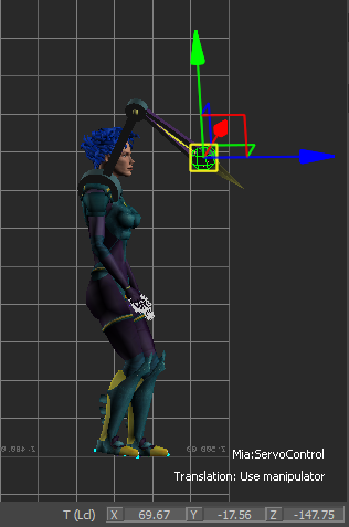

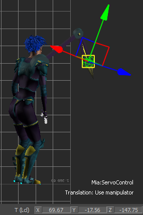

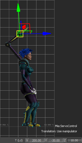

- Go to frame 64.
Mia at frame 64
At this frame, modify the animation so that Mia raises her Servo arm.
- Do the following:
- At the bottom right of the Viewer window, in the Global/Local Reference fields, set the XYZ Translation values to 200 (in X), -30 (in Y), and 10 (in Z).
- In the Key Controls window, click
to set a keyframe.
Frame 64: Servo Arm Control Effector set at 200 in X, -30 in Y, and 10 in Z

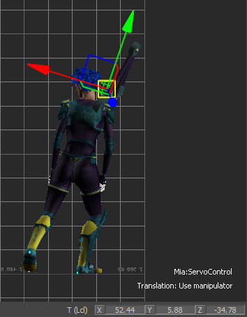

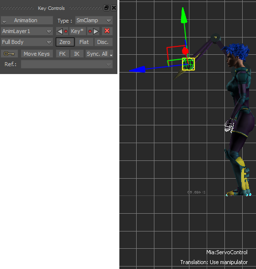

- Go to frame 96.
Mia at frame 96

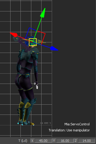

- Set the Servo Arm Control Effector XYZ Translation values to 45 (in X), 16 (in Y), and 14 (in Z).
- Set a keyframe.
to set a keyframe.
Frame 96: Servo Arm Control Effector set at 45 in X, 16 in Y, and 14 in Z

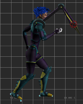

- Go to frame 104.
Mia at frame 104
- Set the Servo Arm Control Effector XYZ Translation values to 35 (in X), -25 (in Y), and 68 (in Z).
- Set a keyframe.
- Play the result animation on AnimLayer1.
- In the Transport Controls, go to the Play Controls and click
to go to the beginning of the take.
- Play the entire take (
) to view all the motion, paying special attention to the Servo arm.
Now, Mia’s Servo arm raises up as she slows and turns.
