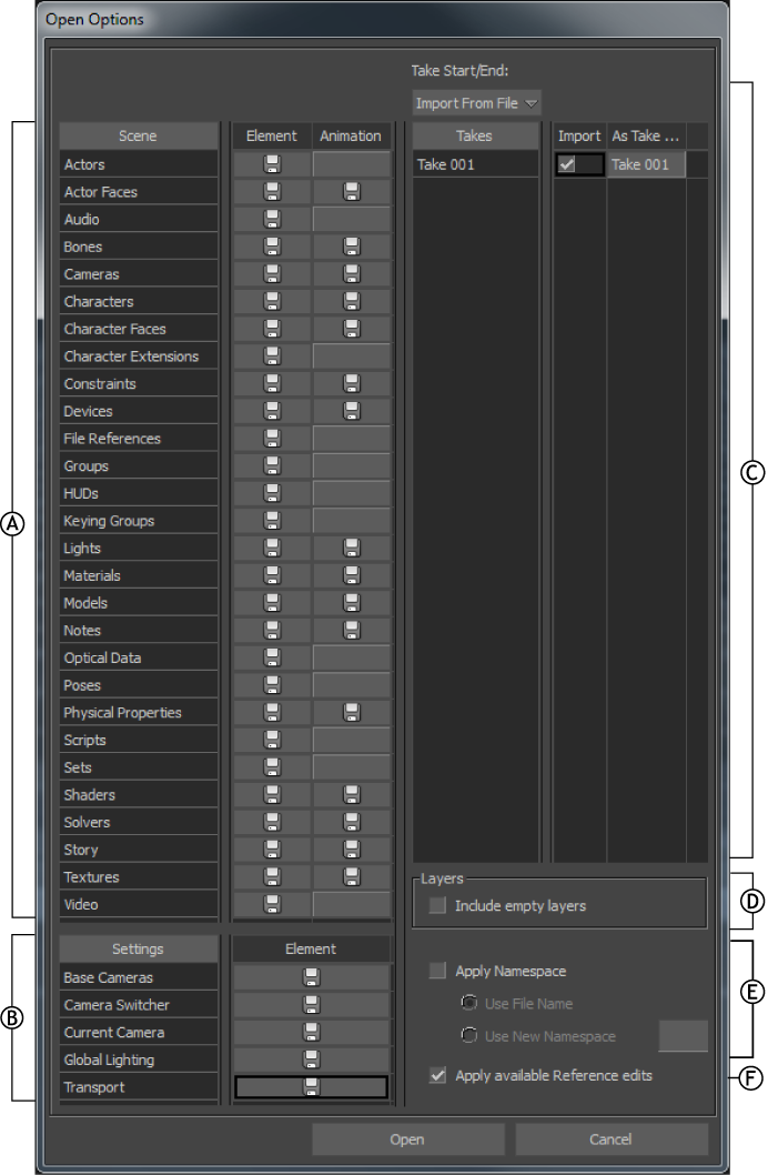

Use the
Open Options window to select elements, animation, settings, takes, layers, and Reference edits —if applicable—to load, and to prepend a namespace for all objects included in the incoming file. Under
Elements,

Open Options window: A. Scene area B. Settings area C. Takes area D. Layers area E. Namespace area F. Reference edits area
Lists each MotionBuilder asset that you can load from the .fbx file being opened.

Lets you select the MotionBuilder settings to load from the file being opened.
Shows all the takes stored in the .fbx file that you are opening. You can also set how the start and end of each take is determined as well as the name given to each take.
Use the Take Start/End field to select how the start and end of each take is determined. You can choose from the following Take Start/End options:

Use the Take list to select which takes to load from the .fbx file. The Take list is split into the following columns:

Lets you prepend a namespace for all objects included in the incoming file.

When on, reference edits are applied to the objects contained in the opened file.
