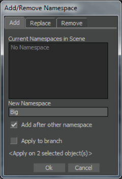

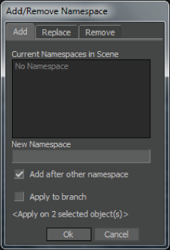

To prepend a namespace to an object:
The Add/Remove Namespace dialog box appears, displaying namespaces in the current scene.
Namespace specified for selected object
Enabling or disabling the option “Add after other namespace” option when there are no namespaces in the scene has no effect.
The specified namespace is added to the object, giving the object a unique name.

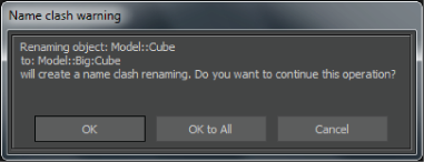

If you have two objects in a scene that carry the same name (for example “Cube”) but one of the objects has a namespace prepended (for example “Big:Cube”), prepending the same namespace (for example “Big”) to the object carrying the same name (for example “Cube”) gives the following warning message.
Name Clash Warning dialog box
If you choose to proceed with the action, a number is prepended to the object’s name to give the object a unique name (for example “Big:Cube1”).

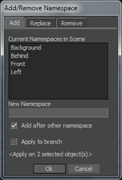

To prepend a namespace to a branch:
Namespace specified for branch
The specified namespace is added to the object’s branch.

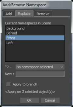

To replace a namespace prepended to an object:
The Add/Remove Namespace dialog box appears displaying the namespaces in the current scene.
Namespaces in current scene displayed
The selected object’s namespace is highlighted.
The object’s namespace is replaced by the specified name.
