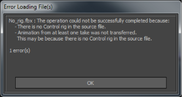

> File > Load Character Animation option in the Character Controls, a dialog box may appear to warn you that the operation was not completed successfully.
Depending on the options you selected in the Load Character Animation Options dialog box and the contents of the source file you selected, you may encounter one or more of the following messages in the Error Loading File(s) dialog box.
To correct this problem, disable the Replace Control Rig option, or make sure there is a Control rig in the source file you select, then try again.

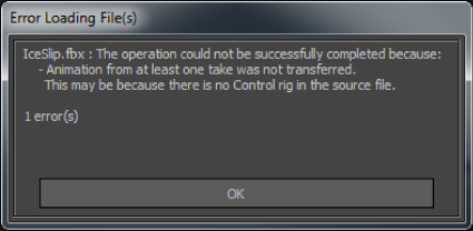

This message can appear for one or more of the following reasons:
Error Loading Files dialog box: Animation was not transferred
