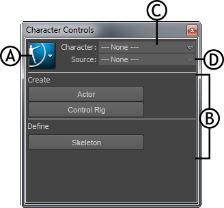

The unified Character Controls window help to perform multiple character setup tasks.
Character Controls window A. Character Controls menu button B. Start pane C. Character menu D. Source menu
The buttons in this pane help you to quickly begin the character setup process. For example, defining a skeleton, creating a HumanIK skeleton, or importing a motion capture example into a scene.

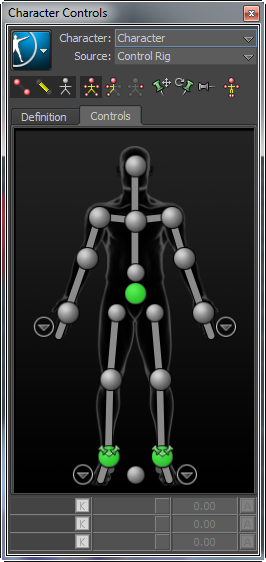

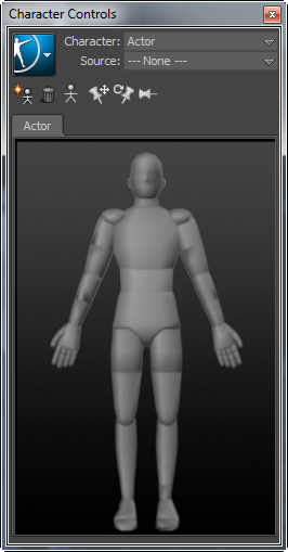

With the Actor asset

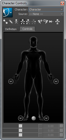

With the Character asset
