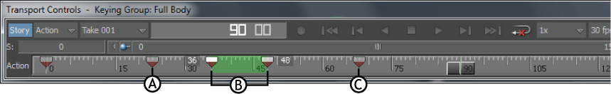

Transport Controls A. Previous keyframe B. Selected keyframes C. Next keyframe
For keyframes on IK effectors, copies the Translation values, Rotation values, or both from the next keyframe to the selected keyframe or keyframe region. See Cutting, copying, and pasting keyframes.

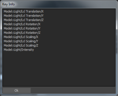

When you right-click a keyframe, the Key Info option displays in the context menu and lets you open a Key Info window. The Key Info window displays information about the keyframe you clicked.
Key Info window
