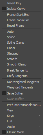

FCurves context menu
The FCurves context menu displays additional options for setting keyframes and function curves. To display this menu, right-click anywhere in the Fcurves pane.
Note: The menu options may change depending on what is selected in the FCurves pane, or on the previous editing operation.
Insert Key
Adds a keyframe at the position of the Timeline indicator to selected properties associated with the selected element or model.
This option is the same as pressing K on the keyboard, or the Key button in the Key Controls window.
Isolate Curve
Displays only one or more curves that you select. To isolate a curve:
  1. Click on a curve to select it (press the Ctrl key to select more than one curve).
  2. Right-click in the FCurves pane and choose Isolate Curve from the context menu.
  3. Isolate Curve is turned on when the box beside the option is selected. Deselecting the box will turn Isolate Curve off and all curves will reappear in the FCurves pane.
Note: If you do not select any curve and choose the Isolate Curve option, then all the curves disappear from the FCurves pane. The curves reappear if you select the Isolate Curve option again.
Frame Start/End
Use Frame Start/End to set the Start and End values of the take. When you use Frame Start/End, the Start value of the take becomes the start time of the earliest keyframe or clip and the End value of the take becomes the end time of the last keyframe or clip.
Frame Zoom Bar
Use the Frame Zoom Bar option to set the Zoom bar start and end values of keyframes or clips.
Reset Frame
Resets an FCurve to display original keyframe values.
Auto
Changes the interpolation mode between the selected key(s) to Auto.
See Auto interpolation.
Linear
Changes the interpolation mode between the selected key(s) to Linear.
See Linear interpolation.
Stepped
Changes the interpolation mode between the selected key(s) to Stepped.
See Stepped interpolation.
Break Tangents
Allows manipulation of the in and out tangent handles individually so you can edit the curve segment entering or exiting the key without affecting its opposite handle.
Unify Tangents
Causes the manipulation of an in or out tangent handle to affect its opposite handle equally. Unify Tangents retains the relative position of the tangent handles even after tangents are individually adjusted (by editing tangents separately after selecting Break Tangents).
Non weighted Tangents
Removes the weighting from weighted tangents of selected keyframes.
Weighted Tangents
Weights both tangents of selected keyframes. See Weight settings
Save Buffer
Takes a snapshot of your curve. Use Swap Buffer to switch between your curve snapshot and the current curve.
Swap Buffer
Toggles between the original curve (the buffer curve snapshot) and the current, edited curve. Allows you to view and play both the curves animations.
Pre/Post Extrapolation
Displays the Extrapolation Options dialog box, which allows you to set pre- and post-extrapolation modes.

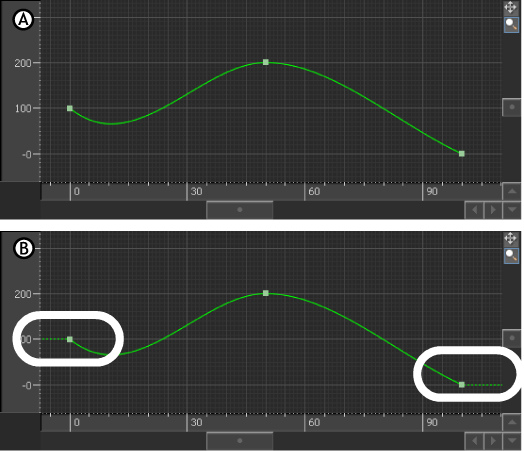

Extrapolation determines the state of a curve before the first keyframe (pre-extrapolation) and after the last keyframe (post-extrapolation).
Once you set the pre- or post-extrapolation modes, the selected function curves display with the extrapolation settings.
Extrapolation A. Function curve without extrapolation. B. The function curve after extrapolation, with both extrapolation modes set to Constant. The extrapolated regions appear as dotted lines (circled).
To change the extrapolation of a curve, select one of the following extrapolation modes in the Pre-Extrapolation or Post-Extrapolation drop-down list.
Constant
Flattens the slope of a curve before the first and after the last keyframe.
Repetition
Duplicates a curve, then places it before the first or after the last keyframe. The Count option repeats the curve a set number of times, and the Infinite option repeats the curve continuously.
Mirror Repetition
Duplicates and mirrors a curve, then places it before the first, or after the last keyframe. Count mirrors the curve and repeats it a set number of times, and Infinite repeats the curve continuously.
Relative Repetition
Use this option to make the Pre-Extrapolation and Post Extrapolation increments relative to the last cycle in the curve. You can turn on a new Infinite option to extend the cycle of the pre and post extrapolation to the full duration of the animation.
View
Displays by default the Visual Keys, Ghosts, Tangents, and audio settings.
Classic Mode
Allows you toggle between the standard FCurves window toolbar with a full set of curve editing and display options, or a more streamlined version of the toolbar with only select editing and display options. If you primarily use MotionBuilder as part of a suite of Autodesk applications, you may prefer to disable Classic Mode and use a more simplified interface in the FCurves window that is more consistent with the other products in your suite.
The options in the View, Keys, Edit, and Audio menus are explained in the following sub-sections.
