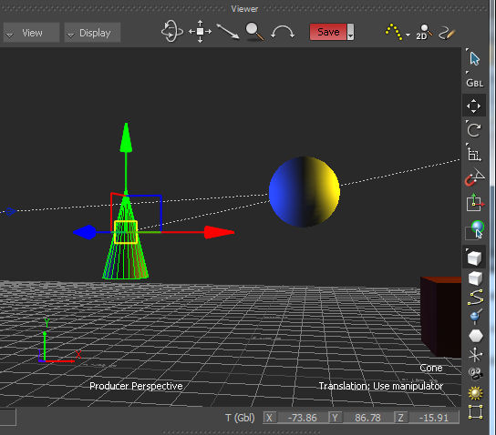

Viewer window Manipulation and Transformation mode tools
The Viewer window Manipulation and Transformation mode tools let you activate the Translation, Rotation, or Scaling modes.
Translate
Select Translate to activate Translation mode and move the selected object according to the Reference mode you have selected.
Translation mode lets you translate objects using the Translation arrows, and by entering values or dragging in the X, Y, and Z fields. For more information about translating objects, see About translation.
