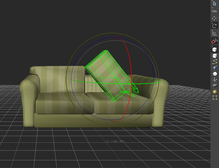

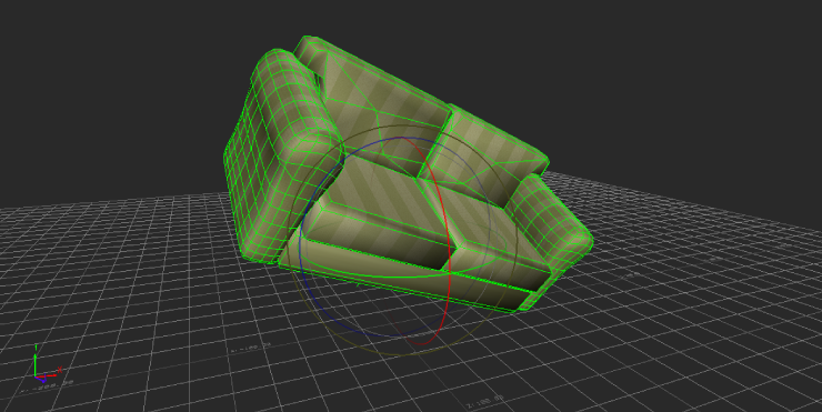

  3. Select the object’s rotation rings in the Viewer window and drag them or enter precise values in Properties windows.
    Selected object in the Viewer window displays with Rotation rings for rotating on the X, Y, or Z axis

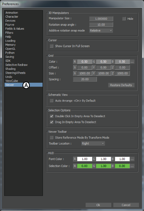

  1. Select Settings > Preferences from the menu bar.
  2. In the Preferences window, select the Viewer preferences (A).
    Preferences window A. Viewer preferences
  3. In the 3D Manipulators area, enter the size of increment (in degrees) in the Rotation snap angle field.
    Tip: Right-click the Snap Rotation button to view the last five increments set for the Snap Rotation and to open the Preferences window and set a new increment size.
  4. Activate the Snap Rotation button in the Viewer toolbar. You can also hold down the M key to activate Snap Rotation mode temporarily.
    Viewer window A. Snap Rotation button
    If no rotation increment is specified, objects rotate in 10-degree increments by default.
