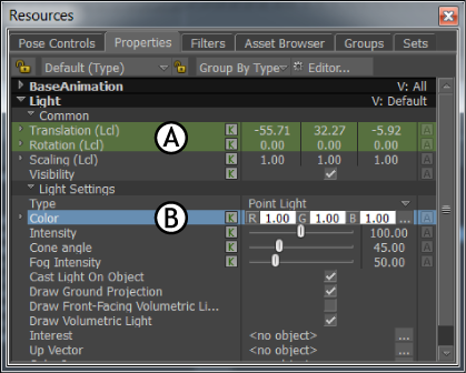

Static keying groups display the properties that they keyframe in light blue. Those properties receive a keyframe when you click the Key button or press the K keyboard shortcut, but they are not selected.
Context Keying Modes A. Light-blue properties receive keyframes B. Color property is selected and can also receive keyframes

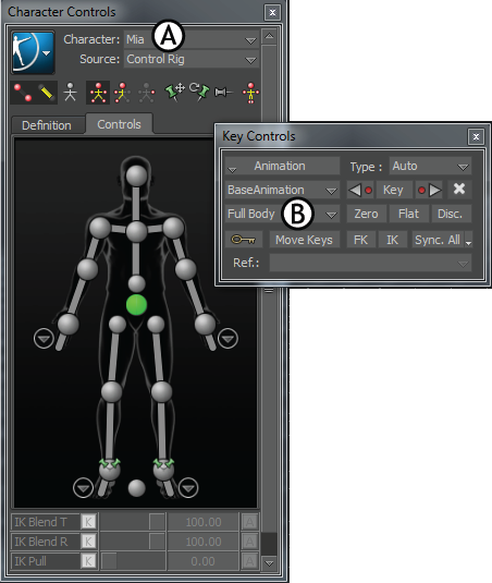

A. Full Body is the Keying group in the Character Controls window B. Full Body displays in the Key Controls window

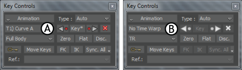

Key Controls window A. TimeWarp curve name B. TimeWarp is active, but there is no TimeWarp curve
If the TimeWarp pane is active but there is no TimeWarp curve, No Time Warp displays in the Key Controls window, and the Keyframe buttons are not available.
