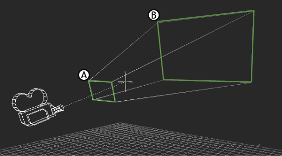

The near plane is the viewing limit closest to the camera. Objects between this plane and the camera do not appear in the scene because they are out of the camera’s viewing area.
A. Near plane B. Far plane
The far plane is the viewing limit furthest from the camera. Objects that move past this plane do not show in the scene because they are out of the camera’s viewing range.
Use the Far plane field to set the distance in pixels of the far plane relative to the camera’s position.

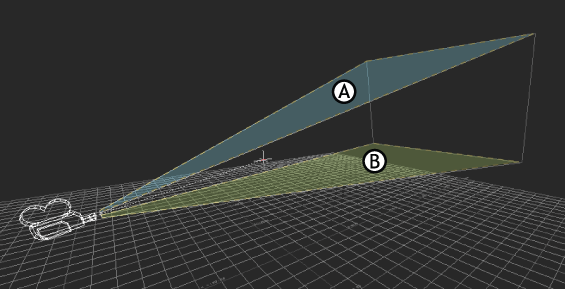

The Field of View settings let you change the angle of the viewing area starting at the camera eye. When the Aperture mode is set to Vertical, the angle of view changes the angle between the top and bottom clipping plane, and so on.
A. Top plane B. Bottom plane
To view a camera’s angle of view, activate the View Near/Far Plane option in the Camera View Options (see Showing the camera Near/Far plane). You can see the camera’s top, left, right, and bottom clipping planes.
When the Aperture mode is set to Horizontal, the angle of view changes the angle between the left and right clipping planes.

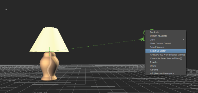

Click the Up Vector field to select the camera’s Up Vector and then translate it. To select a camera’s Up Vector, right-click the camera and choose Select Up Vector from the context menu.
Choose Select Up Vector in the context menu.
