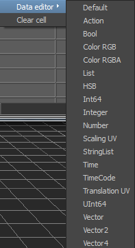

Expression constraint data types
The following table lists and describes each expression constraint data type.
| Data Type | Description |
| Default | Default numerical value expressed as 0.00. Vectors and colors are expressed as {0.00,0.00,0.00,0.00}. |
| Action | |
| Bool | Boolean value (represented by a check box) data type. This value is true (1.00) when the box is checked, and false (0.00) when it is not. |
| Color RGB | RGB color vector value. Each coordinate has its data cell that shows the coordinate’s color. Each coordinate holds a decimal value between 0 and 1. |
| Color RGBA | RGBA color vector value. Similar to the Color data type, but with an additional data cell for the alpha channel. |
| List | |
| HSB | Int64 |
| Int64 | |
| Integer | |
| Number | 0.00 value. When switching from vectors and colors, the new number cell takes the first coordinate. |
| Scaling UV | |
| StringList | |
| Time | |
| Time Code | Ttime code value (000:00:00:00 (00)). |
| Translation UV | |
| UInt64 | |
| Vector | X, Y, Z vector value. Each coordinate has its data cell. When switching from a number cell, the number is placed in the vector’s first coordinate. |
| Vector2 | |
| Vector4 |
