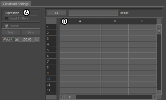

Expression constraints let you constrain the translation, rotation, scaling, and other data of an object (models, lights, cameras, and so on) with that of another object. Unlike other constraints, you construct Expression constraints using a spreadsheet-like interface called the Expression Constraints Settings pane.
Expression constraint A. Sender Cells B. Receiver Cells C. Expression
The Expression Constraint Settings pane contains a total of 500 rows and 26 columns (A-Z).

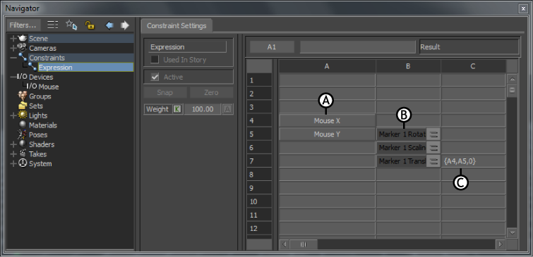

An Expression constraint consists of at least three cells. One cell contains a reference to a Sender while the other two cells are split into a Receiver cell and a mathematical expression.
The cell sending the data can refer to an input device such as a mouse device, and the object receiving data can be a model, light, or an output device. For example, the figure below shows a mouse mapped to a marker in the Expressions pane.
Expression constraint A. Objects area B. Expression Constraint Settings pane
Between the Sender and Receiver, a mathematical expression is used to convert the numerical data from the X and Y mouse values to a vector.
You can use an unlimited amount of mathematical expressions between the Sender cell and the Receiver cell.
