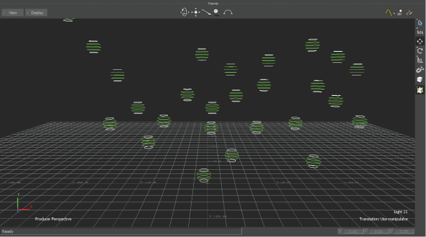

- Click anywhere in the Viewer window to place assets at that point.
The Viewer window updates displaying assets being added to the scene. In the following figure, multiple lights are added.
Viewer window displays multiple lights

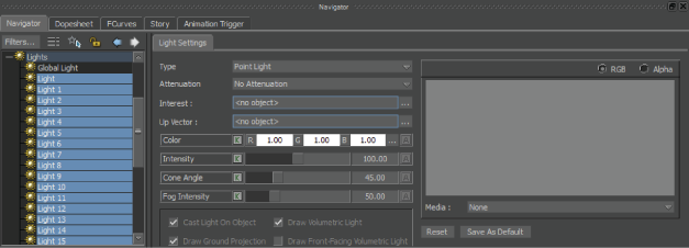

The Navigator window updates to display settings for those assets.
Navigator displays asset settings
