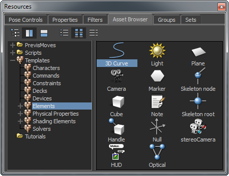

To create a 3D curve:
Asset browser showing the 3D Curve is selected

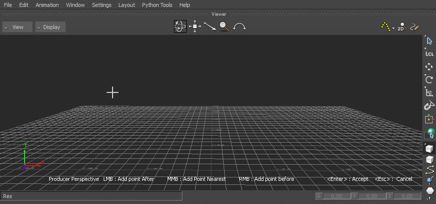

The cursor becomes a cross hair.
Viewer window displaying cursor and keyboard shortcuts for 3D Curve

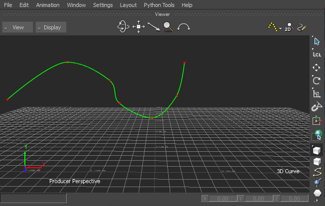

Creating a 3D Curve
(Optional) Use the middle-mouse button or scroll wheel to add a vertex between the points.
(Optional) Click the right mouse button to add a vertex at the start point.
The green line represents the 3D curve. It also shows the 3D Curve is selected.
