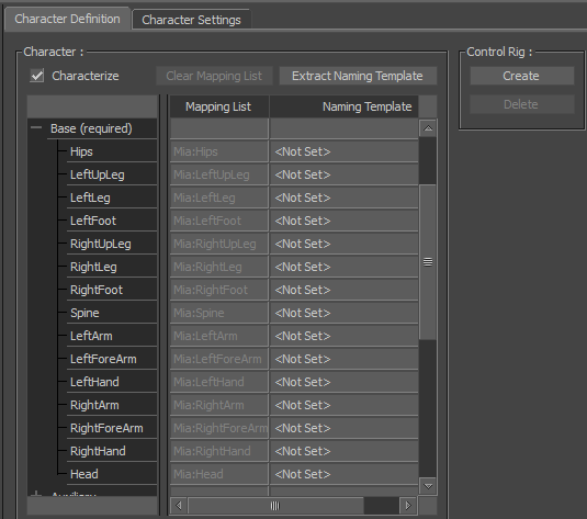

The following procedure shows you how to characterize a model. The moment you characterize a character model, MotionBuilder reads the structure you have outlined in the Mapping list, taking the model’s current pose as the base for all future poses and movement.
To characterize the character model:
Characterize activated

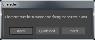

Biped option in the Character dialog box
Generic offsets are calculated so that the character is compatible with any source, the character is characterized, and MotionBuilder recognizes its structure.
Your character is now fully characterized and ready to be animated.
