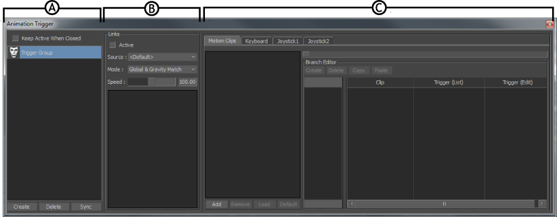

The Animation Trigger window consists of the following:
Animation Trigger window A. Groups pane B. Links pane C. Triggering Options pane
