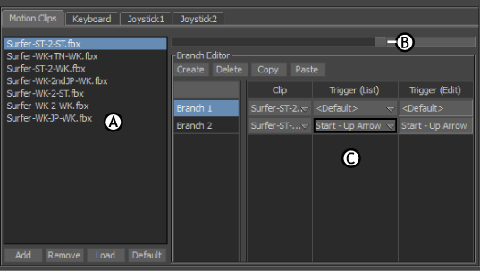

The Motion Clips pane lets you add motion clips to the triggering group and select the triggers that initiate their execution.
Motion Clips pane A. Motion Clips list B. Activity Progress bar C. Branch editor
The Motion Clips list displays all of the motion clips for the selected trigger group and provides the following buttons:
| Button | Description |
| Add | Adds a motion clip to the triggering group. You can use .fbx or .bvh files as motion clips in the Animation Trigger window. You can load all motion clips in a folder at the same time by entering *.fbx (or *.bvh) in the File Name field of the Open directory dialog box. These files must contain data matching the models. For example, if you are animating a bipedal model, you select a clip that has a compatible set of nodes. |
| Remove | Deletes the selected motion clip from the Motion Clips list, and also deletes the branches that use this motion clip. |
| Load | Loads the content of a motion clip into a selected motion clip whose link has been broken. The name of the selected motion clip remains unchanged. |
| Default | Positions the selected motion clip at the top of the Motion Clips list, which makes it the motion clip that is played when no other clip is selected for playing. Default also deselects all motion clips so that the Branch editor is empty. |
| Activity Progress bar | Shows the progress of each motion clip and is only active when the Active option in the Links pane is selected. |
| Branch Editor | The Branch editor lets you create branches of motion clips that can be triggered using the source device. Only one motion clip of a given branch can be triggered at a time. For a description of each Branch Editor column, see Branch Editor. |
The following columns and options make up the Branch editor:
| Column/Option | Description |
| Create button | Adds a branch. By default, the clip of a new branch is set to the selected motion clip and is named consecutively Branch 1, Branch 2, and so on. You cannot rename branches. |
| Delete button | Deletes the selected branch. |
| Copy button | Copies the entire list of branches associated with the selected motion clip. You can paste this list onto another motion clip using the Paste button. |
| Paste button | Pastes the list of branches onto the selected motion clip and replaces the previous list. |
| Clip column | Selects the motion clip to execute from the Motion Clips list. If the Active option in the Links pane is selected when you modify the Clip column, the current motion clip in the Motion Clips list switches to the clip you just selected. |
| Trigger (List) column | Specifies the trigger that executes the branch. Triggers are defined in the Keyboard, Joystick1, or Joystick2 panes depending on the device. See Keyboard and Joystick panes. |
| Trigger (Edit) column | Edits the name of the trigger selected in the Trigger (List) column. To edit the name, double-click the field, type the name, and press Enter. Note: This option is useful only when you are creating branches for your motion clips before you define the triggers in the Keyboard/Joystick panes.
