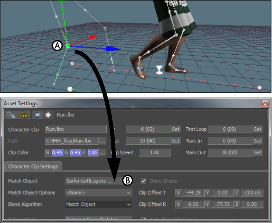

Double-click an animation, character, or camera animation clip in the Story window to access the Match Object field in the Asset Settings window.
The Match Object field lets you select a match object for each selected animation, character, or camera animation clip. The match object you select affects how clips match. By default, a clip has no match object and the travelling node is used to match clips.
To select a match object, Alt-drag an object into the Match Object field. You should only select a match object from part of the track contents.
Selecting a match object A. Drag a selected node into the Match Object field B. The name of the custom match object displays in the Match Object field

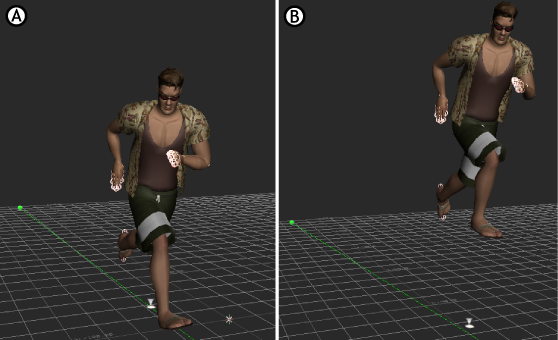

Creating loop offsets A. The loop offset is calculated automatically, Surfer runs in a straight line. B. The loop is offset along the Y and X axes, causing Surfer to jump at the beginning of each loop.
