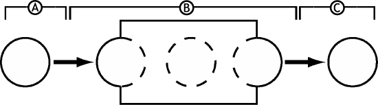

One problem inherent with optical motion capture is occlusion, when a sensor is hidden from all but three cameras. This occurs when a performer passes by an obstructing object, or when the performer’s body comes between the sensor and the camera. Occlusion is impossible to avoid because no single camera angle can capture all sensors at once. Cameras cannot look through the body of a performer to find hidden sensors.

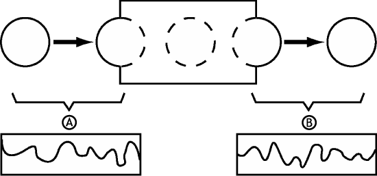

When occlusion happens, the sensor disappears from the camera view, and the computer has no way of knowing where it went. When occlusion ends and the sensor reappears, some optical capture systems treat the sensor as a new sensor and add a data segment at the location where the sensor reappears.
A. Sensor traveling through space B. Object obstructing the camera’s view of the sensor C. Sensor emerging from behind the obstruction
A. Sensor’s position tracked and recorded as a segment B. Sensor can no longer be tracked C. A sensor appears and the system records a new segment

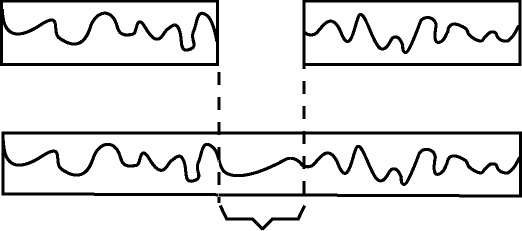

New data segment begins A. Segment 1 is recorded B. New segment is recorded using the same sensor
Therefore, the raw data capture generates a large number of disconnected data segments. It is not uncommon for a thirty-second capture session to generate hundreds of different data segments.
