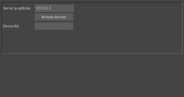

This topic explains the options in the Network Client device area and their uses.
| Option | Description |
| Server IP address | Address of the machine running MotionBuilder with the Network Server device. |
| Browse devices | Click to view a list of all the devices added to the MotionBuilder Network Server. |
| Device menu | Click Browse devices to list all the Network Server’s devices in this menu. Select the device to which you want to connect this Network Client. |
| Connect Device | Connects the device selected in the Device menu to the Network Client. |
| Reset | Re-establishes the connection. (Click Reset if you lose the connection.) |
