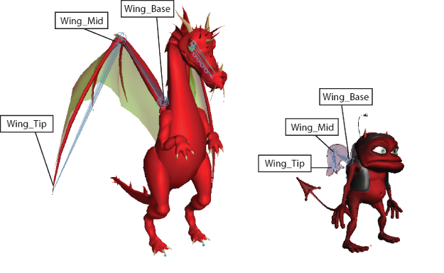

A dragon character with wing and tail Character Extensions.

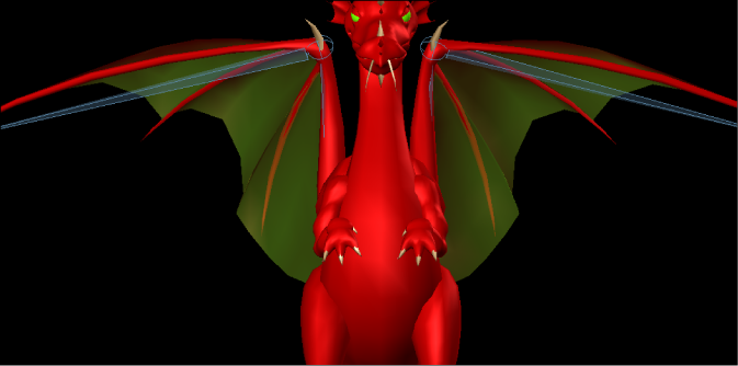

With the proper setup, you can also mirror-paste poses on Character Extensions just as you can on the regular body parts of a character. For example, if your character has symmetrical left and right wings, you can mirror poses from the left wing onto the right wing, and so on.
Just like the right arm is the mirror of the left arm in a character structure, you can set up right and left mirror pairs for Character Extensions. You can also mirror poses on a single Character Extension, such as a tail, the same way you can mirror poses on the spine of a character.

Two Character Extensions set up for copying animation
