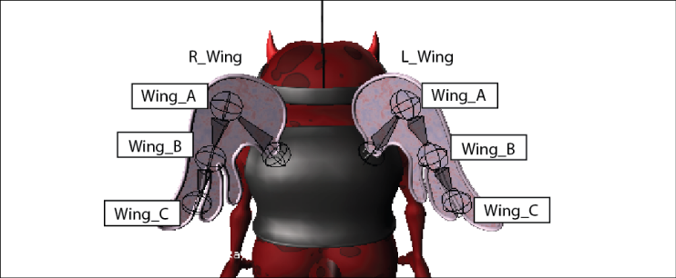

Character with two wings set up for symmetrical mirroring
When you select the Extension Label for one Character Extension in the Mirror Partner menu, MotionBuilder determines whether the set up of the selected Extension matches the current Extension exactly. In order for two Extensions to function as a perfect mirror pair, both Extensions must be composed of objects with identical Label names and property references. If the setup for the Extension you choose in the Mirror Partner menu is not an exact match for the current Extension, a dialog box appears that reports the unmatched objects and properties.
