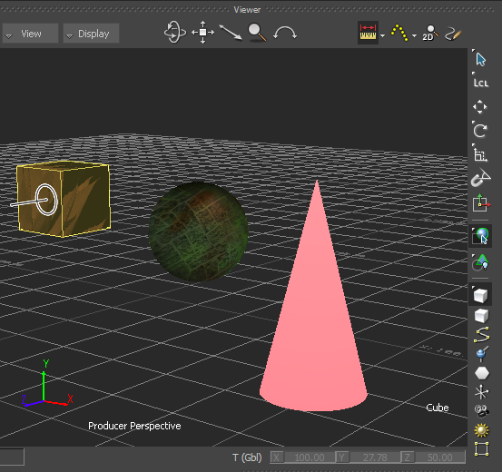

The cursor changes to a 2D cursor (
The object highlights.
) enabling you to snap to the surface of the object.
The 3D cursor is shown snapping to the surface of the cube.
The system Ruler "object" start point snaps to the surface of the object. The measuring distance displays and updates dynamically as you start to move the cursor.

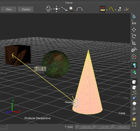

The cursor changes to a 3D cursor (
3D cursor is shown snapping to the surface of the second object
The system Ruler "object" end point snaps to the surface of the second object and displays the distance between the two objects from their surfaces.
