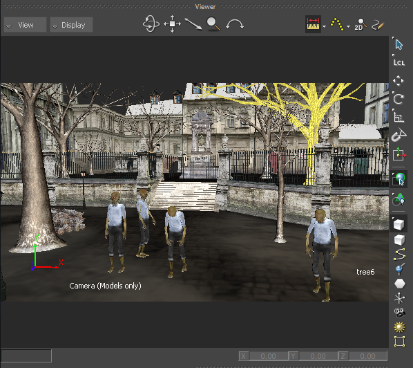

When you click the
Ruler tool (
) and hover over an object or element in the scene, the object is highlighted in yellow by default and the name of the object is displayed at the bottom right of the
Viewer window, as shown in the following figure.
If you are working on a large scene, the highlighting of objects enables you to quickly identify and select in the scene the objects whose distance you want to measure.

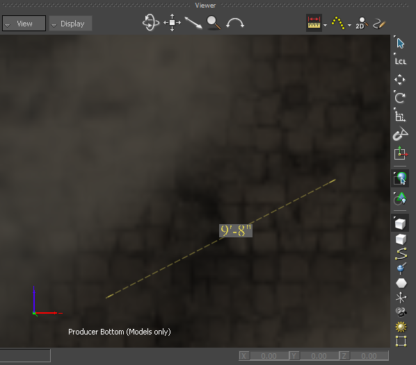

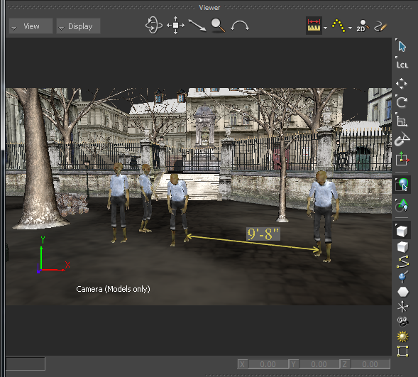

When you measure the distance between two objects or elements in the scene, the measured distance is displayed by default by a yellow line with arrows at the start and end points and the measurement units above the line. This measured distance is a system Ruler "object".
Ruler "object" displayed in the scene
The distance measurement units always face the current camera view, enabling you to see the measured distance irregardless of the camera view.
Measured distance facing the Orthographic Producer Bottom view

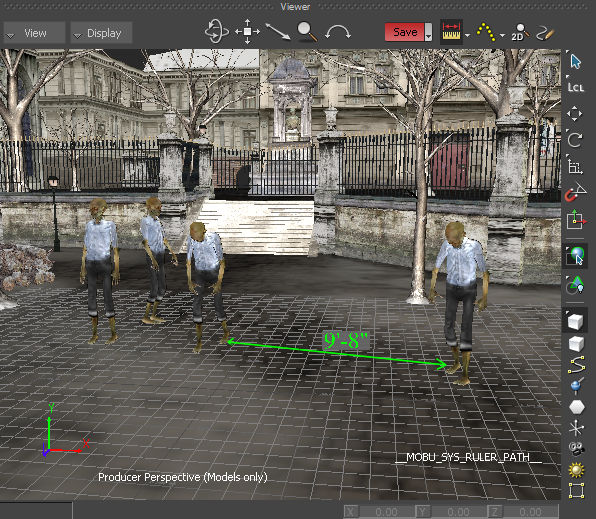

The system Ruler "object" is displayed in green when selected and the Viewer window indicates it is selected by displaying __MOBU_SYS_RULER_PATH__ at the bottom right, as shown in the following figure.
Ruler "object" shown selected
The system Ruler "object" is a system Ruler path. It is not an asset nor a model object. It has no properties and therefore is not available in the Asset browser, the Navigator Scene browser, and nor in the Schematic view.
