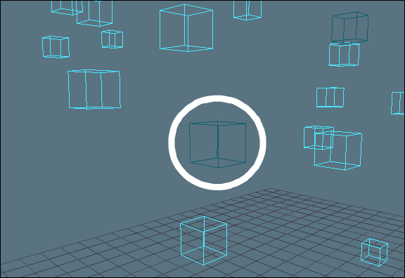

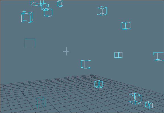

Occluded segments shown as dark blue cubes
Markers show up as occluded only after they have been associated with at least two data segments, or have been connected to other markers using a Rigid body.
The dark blue markers serve as a mathematical estimate of where the occluded marker should be in the scene. This estimate is based on interpolation between data segments and placement based on Rigid bodies.
