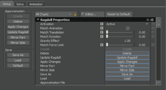

Ragdoll Setup pane
The Ragdoll Setup pane is where you configure options that are generic settings, or system overrides.
The Setup pane includes the Approximation options, Save options, and the property settings.
The Ragdoll Property options display along the top of the Ragdoll Setup pane. These Property options are the View menu and Lock option, the Editor button, and the Reset to Default button to restore the Ragdoll properties to their original settings.
The Ragdoll Approximation and Save options let you create a proxy or a “Dummy” for your character. It includes the Approximation menu and the Save menu.
Approximation menu
Option Function
Create Generates a proxy model.
Delete Deletes the proxy model.
Apply Changes Applies current changes to the Ragdoll proxy model information, such as changes to color, size, mass, and so on.
Update Ragdoll Updates the approximation to match the character pose when it has been transformed into a different position.
Note: The Physics solver cannot be set to Live while you pose the character.
Mirror Part Mirrors a body part to the other side, or mirror the entire side.
Mirror Side Mirrors a side of the character body to other side.
See Creating a Ragdoll Approximation for more.
Save menu
Use these options to create a text file that contains any modifications made to the current solve.
Option Function
Save as Save the current modifications as a text file.
Load Lets you open a previously saved set of solve modifications.
Default Sets the current settings as the default in the current Config file (DefaultRagdoll.txt) so that any time you click Reset to Default, the properties are reset to this state.

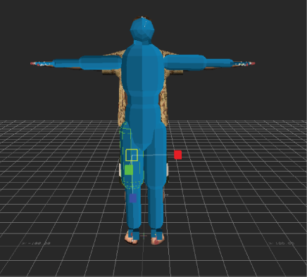

Manually adjusting the Ragdoll approximation
Since the Ragdoll approximation is generic creation, you can achieve better results if you customize it. You can select and transform the Ragdoll approximation components to create a better fit for your character. This can be especially useful when you work with pose matching.
Scaling a thigh approximation component.

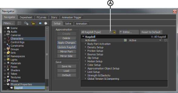

The All Ragdoll (Type) settings let you configure the settings for the solve.
Ragdoll Setup pane A. All Ragdoll (Type)
Expand each heading to expose a list of properties for body parts on which you can set custom levels for your solve.
Certain body-part settings only appear when you change the Ragdoll View menu to All Ragdoll (Type) or a specific body part view (for example, Right Foot). The following is a list of options available when All Ragdoll (Type) is selected in the View menu (A) and when there is an approximation in the scene. Otherwise, the description of the settings states which Ragdoll view to use.

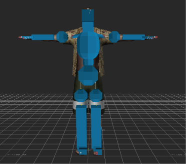

Approximation Object Setup
Expand Approximation Object Setup to expose a list of body parts for which you can choose an approximation shape that best fits the character. Select Capsule, Sphere, Box, or Mesh.
Ragdoll approximation with non-standard object shapes.
