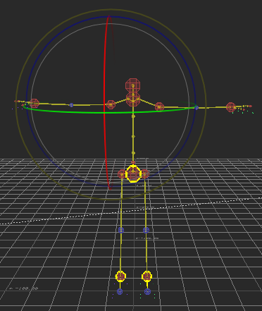

The Control Rig is created and its effectors are shown on the biped skeleton in the Viewer window.
3ds Max skeleton is characterized and rigged

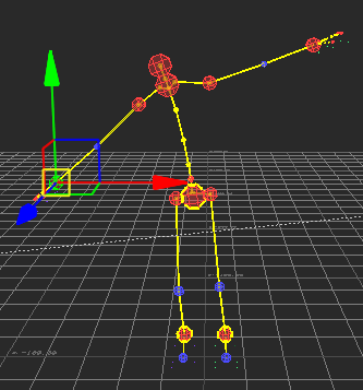

Character representation Right Wrist effector selected
An effector that is selected is displayed with a blue (
) contour.
) or click in the Viewer window and press T. The transformation handles appear.
3ds Max skeleton body follows the hand movement
Notice as you move the hand, the arm extends and the rest of the body follows in a natural movement.
