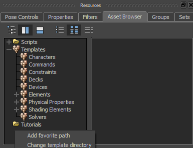

To add a favorite path to the Asset Browser pane:
- In the Resources window, make sure the Asset Browser tab is selected.
- In the Asset Browser, right-click the Asset Browser pane.
A context menu displays.
- Click Add favorite path from the context menu.
- In the Open directory window, navigate to the directory you would like to add in the Asset Browser.
- Click the directory and then click OK.
The directory is added to the Asset Browser pane in numeric alpha order.
