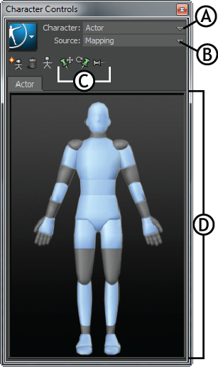

Actor Controls window A. Character drop-down list B. Source drop-down list C. Effector pinning buttons D. Actor representation
Displays the name of the current Actor to which all options apply. When switching from an Actor to a character using this menu, the options in the Actor Controls window are replaced and become contextual to the current character.
Select an Actor in the Actor Controls window by making a selection from the Character drop-down list.
The Actor is divided into cells that represent the joints of the Actor. Selecting a cell lets you manipulate that part of the Actor using Inverse Kinematics.

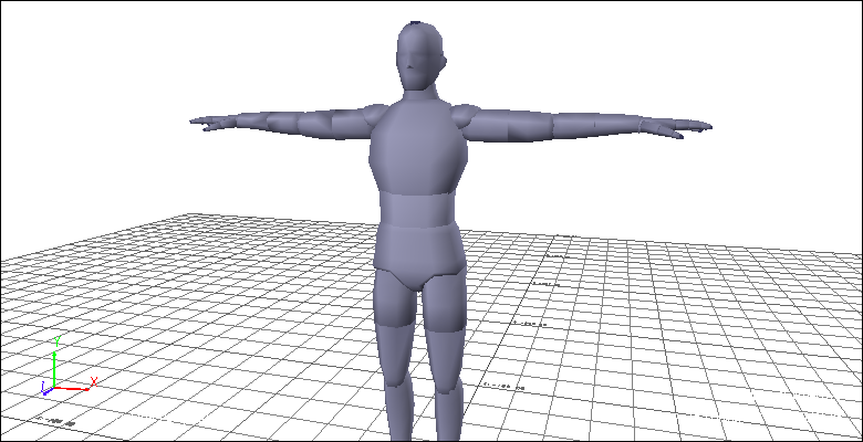

| Stance Pose | Activate Stance Pose to position the Actor in its default stance position. You can use this pose to reset and modify the Actor’s position. Stance Pose only resets rotational offsets. These offsets remain if you translate or scale the model. |
Actor Stance Pose

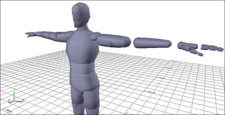

| Collapse | Activate Collapse to rejoin any detached limb segments of an Actor without resetting the Actor’s size or stance. This may be necessary in certain situations. For example, when adding position offsets to an Actor or when translating source markers further than their initial definition, some limbs may detach to reach all the markers defined by its Marker set. |
| Reset Size | Select Reset Size to reset the scale of the selected Actor to its default size. If a scaling offset affects the position of a segment, Reset Size resets the scale of the Actor, but leaves the segment at its new location. |
Reset Size resets the scale of the left arm but keeps the position of the left hand, detaching segments of the arm
