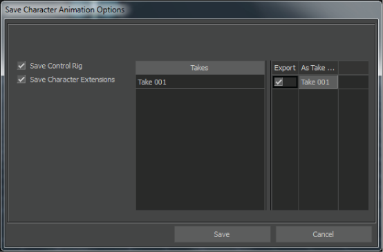

Lets you save the animation in the current character. You can choose to save the Control rig with one or multiple takes.
This dialog contains the following options:
See Saving a character animation for more information.
