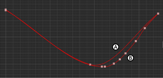

For example, in an animation curve displays before (A) and after (B) plotting when Plot On Frames was active. The Start time code is 0 and the End time code is 5. After plotting, the keyframes are set exactly on each frame in the animation.
Plot on Frames A. Original curve before plotting B. Curve after plotting with Plot on Frame

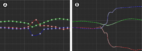

Select the Unroll option to unroll equivalent Euler rotations, making the curves continuous.
Unroll A. Original curves B. Unroll applied

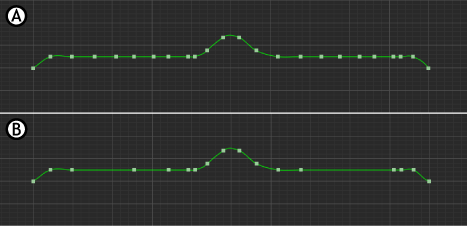

Reduces the number of keyframes by eliminating redundant keyframes. Reducing the number of keyframes reduces the file size. This filter is active by default.
For example, the following figure shows a function curve before (A) and after (B) the Constant Key Reducer filter is applied, reducing the number of redundant keyframes used by the function curve.
Constant key reducer A. Original curve B. Constant Key applied

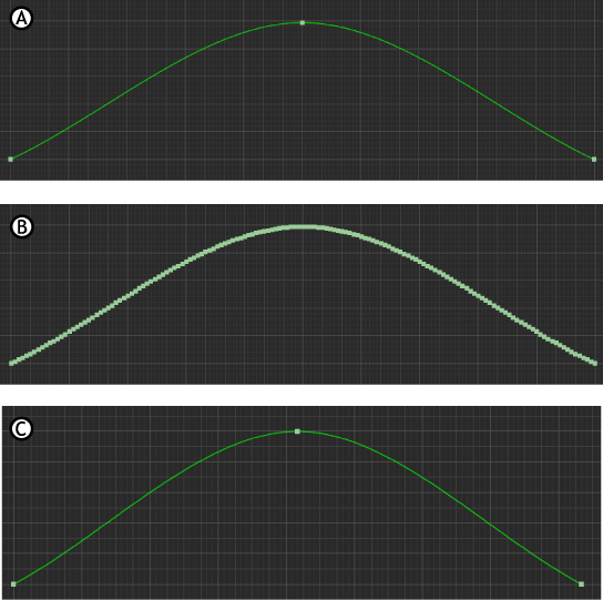

Lets you plot keyframe animation without adding extra keyframes. For example, this option is useful when you want to merge the keyframes you set on many layers. Using Smart Plot, you can merge the keyframe layers without adding more keyframes, letting you continue to edit your original keyframe animation easily.
For example, plotting a function curve that has three keyframes without using Smart Plot creates many keyframes, which are too numerous to edit easily. However, when plotted using Smart Plot, the resulting animation still has only three keyframes.
Keyframe animation A. Original keyframes B. Keyframes plotted without Smart Plot C. Keyframes plotted with Smart Plot

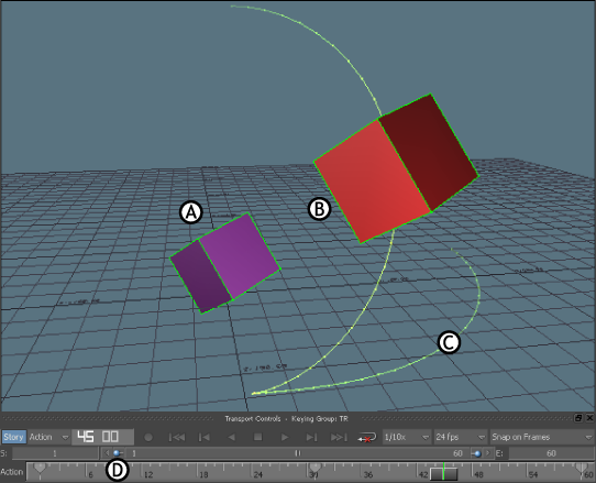

If you plot this animation using Smart Plot without Increase Fidelity, the keyframes at frame 0, 30, and 60 are plotted to both cubes, but the animation’s trajectory changes (see B in the following figure) because Cube1 needs more keyframes to retain its original animation.
Animation plotted without Increase Fidelity A. Cube1 B. Cube1 trajectory altered C. Three few keyframes plotted to Cube1

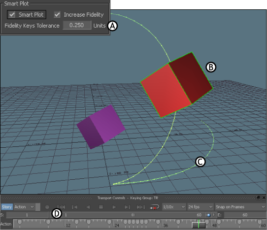

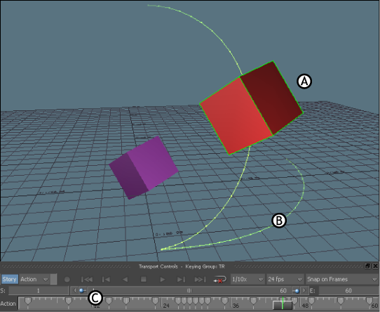

For example, in the following figure, the Fidelity Keys Tolerance field is set to 0.25, which is the default setting. Plotting sets many keyframes to Cube1, recreating the original animation path. However, you may not want so many keyframes.
Plotting A. Fidelity Keys Tolerance field B. Cube1 C. Cube1 trajectory similar to the original animation D. Keyframes plotted to Cube1 recreate original animation

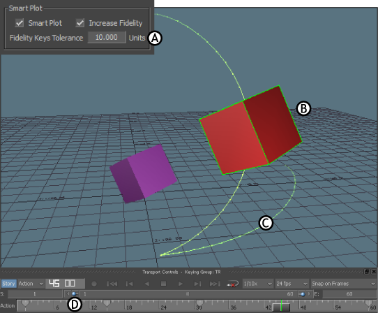

When the Fidelity Keys Tolerance field is set to a higher value, plotting sets fewer keyframes, but the animation path can change depending the number of keyframes.
Plotting A. Fidelity Keys Tolerance field B. Cube1 C. Cube1 trajectory different than the original animation D. Five keyframes plotted to Cube1

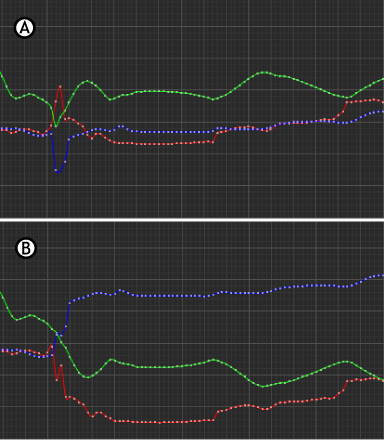

You can also use the FCurves window to compare the animation. For example, compare the X-axis Rotation function curves of the animation shown in the following figure A and B.
FCurves window A. Rotation function curve of Cube1 with Fidelity Keys Tolerance field set to default value (0.25)B. Rotation function curve of Cube1 with Fidelity Keys Tolerance field set to default value (10.0)
