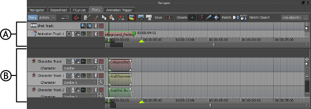

The Story window lets you assemble scenes by combining and manipulating elements such as characters, lights, cameras, audio, and animation along a timeline, much like a non-linear editor.
To access the Story window, select Window > Story from the menu bar.
The Story window is made up of the Action and Edit Timelines, which look similar but are used for different purposes. For example:
You can switch between these two timelines by clicking the Story Mode icon at the top left corner of the Story window.
Story window: A. Edit timeline B. Action timeline
For information about Story window controls and context menus, see Story Reference.
