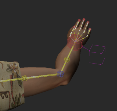

Auxiliary effectors are supplementary effectors in a Control rig that correspond to existing IK effectors. Every IK effector in a Control rig can have multiple Auxiliary effectors.
Auxiliary effector displays on a wrist effector
Adjusting Auxiliary reach A. Right wrist effector Auxiliary effector selected B. Hand reaches between IK effector and Auxiliary effector C. Auxiliary effector is translated away from right wrist
