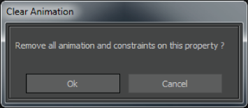

The Animate (A) button lets you set keyframes, use Blend values in constraints, and remove animation from a Blend property. To use a Blend value in a Relations constraint, click the Animate (A) button.

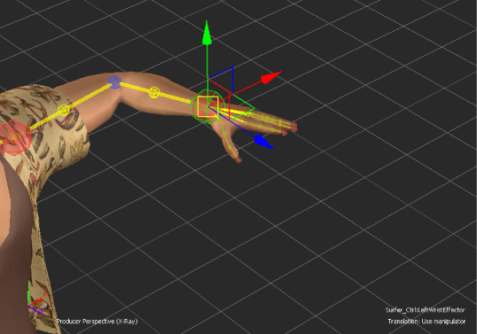

The IK rig and FK rig are synchronized at keyframes

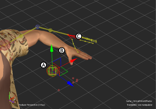

Between keyframes, the IK rig (A) and the FK rig (B) do not match since each rig uses a different method of solving.
The Blend T and Blend R sliders let you adjust the amount of influence each system (IK or FK) has on a body part when the two systems get out of sync. This gives you complete control of what happens between keyframes.
To adjust the influence each system has, select an effector in the Character representation, then adjust the percentage of translation and rotation blend between the IK and FK rigs using the Blend T and Blend R sliders.

A. Blue IK wrist effector is selected B. Character’s arm reaches towards the FK rig since the wrist effector’s IK translation blend is set to 30% C. Yellow FK rig
If the Blend T value was set to 50%, the skeleton appears between the FK and IK rigs. The solution of the IK rig and the FK rig is blended together equally to influence the body part.
