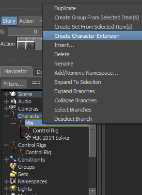

To create a character extension:
- In the Navigator window Scene browser, expand Characters, right-click Mia, and select Create Character Extension from the context menu.
The Mia (Character) Extension is displayed under the Characters branch and the Character Extensions branch.

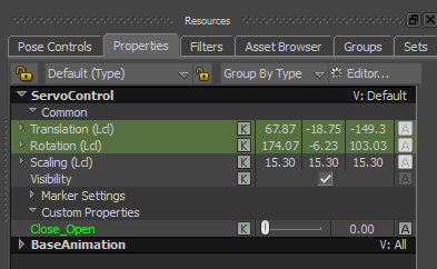

- With the ServoControl effector still selected, in the Properties Resources window (at the bottom right of the interface), click the Properties tab.
- Under the ServoControl properties, drag the slider of the Close_Open property left and right.
In the Viewer window, notice the pincer opens and closes as you change the Close_Open value.

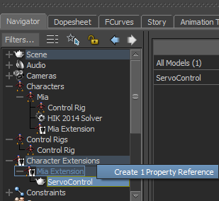

- In the Properties Resources window, Alt-drag the Close_Open property in the Navigator window Scene browser over the Mia Extension and select Create 1 Property Reference from the context menu.

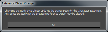

The Reference Object Change dialog displays.
- Click OK.
Mia’s right shoulder bone is now set as the Reference object for the Character Extension.
The Reference object for your Character Extension is used to calculate all future positioning of the Extension, for example when the Character Extension is included in a pose.
