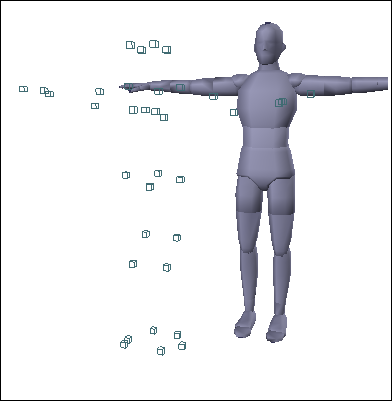

Before creating a Marker set, you must establish a zero point for your Actor, which is the stance where both translation and rotation are set to zero. By default, the Actor settings use the T-stance as the zero point. All subsequent movements are based on this zero point.
If your capture session does not begin with a T-stance, the limbs of the Actor must be rotated to meet the starting location of the motion capture markers or sensors.
Even if you started the capture session with your performer in a T-stance, you should reposition and scale the Actor to the sensors before you create the Marker set.
After you activate the Marker set in the Actor, you may also have to adjust the position, rotation, or scale of the Actor’s arms, legs, torso, chest, or head.
