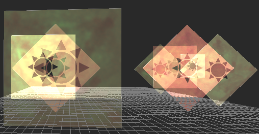

Selecting textured geometric elements in a dense scene via the Viewer window can be challenging and time consuming especially if the elements are occluded by other elements. You can change the camera view or use the Navigator window to access and select elements behind other elements but this workflow may be quite inefficient particularly with large scenes.
The following table lists the keyboard shortcuts and User Interface (UI) elements associated with the selection and display of occluded textured geometric elements in the Viewer window. The keyboard shortcuts are supported in all default and custom cameras.

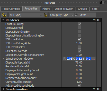

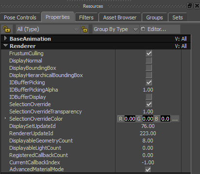

| To enable the selection override color for selecting occluded geometric elements. | Alt + Shift + Q |
SelectionOverride |
Enable the SelectionOverride property in the Renderer Properties Resources. |
| To disable the selection override color for selecting occluded geometric elements. | Alt + Shift + Q |
SelectionOverride |
Disable the SelectionOverride property in the Renderer Properties Resources. |
| To define the selection override color for selecting occluded geometric elements. |
None |
SelectionOverrideColor |
Define the selection override color in the SelectionOverrideColor property fields or button in the Renderer Properties Resources. |
| To define the selection override color transparency for selecting occluded geometric elements. |
None |
SelectionOverideTransparency |
Adjust the value of the SelectionOverrideTransparency property in the Renderer Properties Resources. |

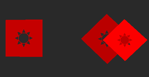

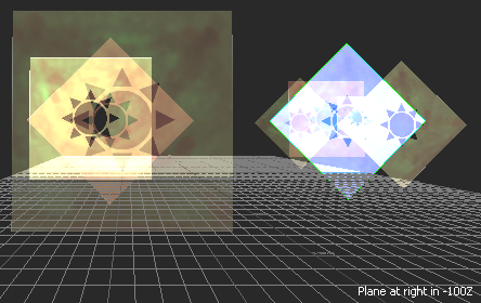

| To select and cycle through textured geometric elements with a selection override color. | Click a geometric element and press Shift + 1 + scroll mouse wheel |
None |
| To cycle through textured geometric elements with a selection override color and hide the geometric elements in front of the selected geometric element. | Click a geometric element and press Shift + 2 + scroll mouse wheel |
None |
| To hide textured geometric elements with a selection override color in front of the selected textured geometric element. | Click a geometric element and press Shift + 2 |
None |
| To show only the selected textured geometric element. | Click a geometric element and press Shift + 3 |
None |
| To isolate the selected textured geometric element with a selection override color and then scroll through all the geometric element with a selection override color (one by one). | Click a geometric element and press Shift + 3 + scroll mouse wheel |
None |
imilarly to selecting occluded geometric elements through alpha channels, you can select a geometric element in the background through partially transparent textured geometric elements in the foreground by using the Easy Selection button (
) in the Viewer toolbar or its keyboard shortcut (Alt +
Shift +
A), and by specifying the texture's selection override color. Setting a selection override color uses the textures' diffuse channel for the color override.
To select an occluded textured geometric element in the Viewer window by using a selection override color:
) and picking a color in the Color window.
Setting a selection override color enables you to easily see which textured geometric element is selected.
If you are working in a dense scene containing geometric elements with various subtle transparent textures, taking advantage of the Renderer's SelectionOverrideColor property optimizes the selection process.
To select and cycle through textured geometric elements with a selection override color:
The textured geometric elements with a selection override color are selected one by one using the Z buffer.
To hide textured geometric elements with a selection override color in front of the selected textured geometric element and then cycle through the textured geometric elements (with a selection override color) in the back:
The textured geometric elements in front of the selected geometric element are hidden and the geometric elements in the back are selected one by one using the Z buffer.
To hide textured geometric elements with a selection override color in front of the selected textured geometric element:
To show only the selected geometric element with a selection override color:
To isolate the selected textured geometric element with a selection override color and then scroll through the geometric element with a selection override color (one by one):
