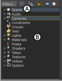

The Asset list in the Navigator window's Scene browser lists all the assets in your scene in a hierarchy with your scene as the root (Scene folder) and alphabetically by asset (Asset folders).
The Scene folder appears at the top of the Asset list, and contains a hierarchy of all assets in the scene.
Beneath the Scene folder, a separate Asset folder displays for every added asset. Asset folders are organized alphabetically in the list. For some assets, a folder is not listed if no assets of that type were added to the scene.
A. Scene folder B. Asset folders

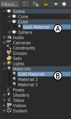

When you select an asset in the Viewer or other windows, the Asset list shows the selected asset in both the Scene folder and its corresponding Asset folder. For example, the following figure shows the selected material named “Gold Material” in both the Scene and Materials folders.
A. Selected material displays in the Scene folder. B. Gold Material also displays in the Materials folder

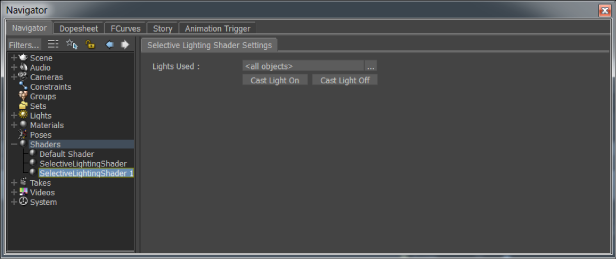

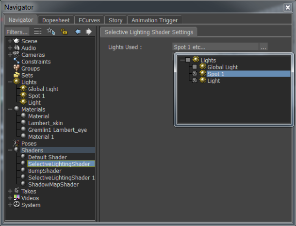

The Asset list is an interface item that lets you specify one or more assets. The Asset list is found next to the Asset field in many Navigator window panes, for example the Selective Lighting Shader settings.
Selective Lighting Shader Settings

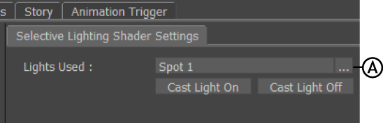

Access the Asset list through the Asset list button (...) that appears next to the field.
Asset Selection List A. button

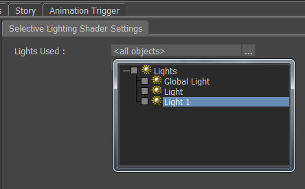

When you click the Asset list button, a list of all the corresponding assets added to your scene displays.
Assets used in the scene
The Tree/List options let you choose which way you want to view the contents of the Asset list.
Select Tree to make the Asset list display in a tree hierarchy with check boxes that are either activated or disabled. Select List to make the Asset list for the selected objects display as a list. Unlike the Tree display, the List display only shows selected objects.

To select items from the Asset Selection list:
The Asset list appears with assets appropriate to the asset you are selecting. For example, if you are using the Lights Used Asset list, all the lights used in the scene are displayed.

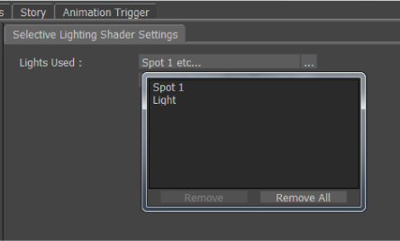

To remove items in your Asset list:
A list appears with all the assets you have assigned.
