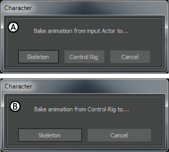

Transfers animation from the selected input source to your model skeleton or Control rig.
Depending on what you select as the input type and source, the Character dialog box that appears when you click Plot Character preovides different options.
Character dialog box A. Actor input source B. Control rig input source

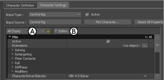

Lets you browse and adjust all of the properties associated with a selected character. You can change how your character reacts to the input source, how the Control rig behaves, whether floor contact for hands and feet are active, and many other properties.
There are seven Property views that list the same options as the Default view. Each view is organized to make it easier to find certain properties. For example, the Pull view only lists properties that pertain to effector pulling in the Control rig.
Character Settings pane A. Select Property View drop-down list B. Editor button
