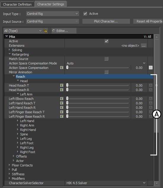

Activate Mirror Animation to mirror then position of a character along the X-axis. For example, you can activate this option to transfer the source data on the left arm to the right arm, and vice versa.
If your source is a Control rig, activating Mirror Animation mirrors your motion as your animation is plotted from your model skeleton to the Control rig.
Character Settings pane A. Retargeting > Reach settings
Almost all Reach T and Reach R settings are also accessible from the Character Controls window. Reach is different when your character’s source is set to Control Rig In. See Blend and Pull controls for more information.
To control the amount of reach, drag the setting’s slider, or type a value in the numerical field. Use the following guidelines when manipulating reach with the sliders:

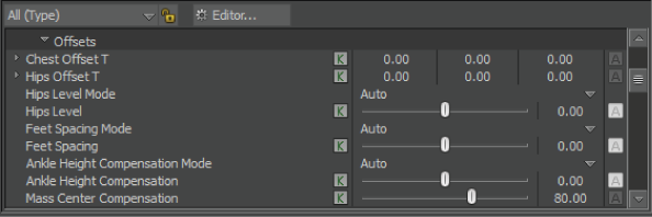

Retargeting > Offsets settings
| Setting | Function |
| Chest/Hips Offset T | Lets you precisely apply and adjust offsets to the chest and hips. For the offset to affect the chest, the Reach Chest option must be set to any value other than 0. |
| Hips Level Mode | When set to Off, Hips Level is disabled. When set to User, you can manually adjust the level of the hips by changing the value of the Hips Level. When set to Auto, Hips Level is automatic. By default, the Hips Level Mode is set to Auto. |
| Hips Level | Lets you control the level of the hips relative to its center of gravity. You can select User, Off, and Auto options from the Hips Level Mode menu. |
| Feet Spacing Mode | When set to Off, Feet Spacing is disabled. When set to User, you can manually adjust the spacing of the feet. When set to Auto, the Feet Spacing is automatic. By default, the Feet Spacing Mode is set to Auto. |
| Feet Spacing | Lets you adjust the amount of spacing between the feet of the model relative to the spacing between the feet of the source. |
| Ankle Height Compensation Mode | When set to Off, Ankle Height Compensation is disabled. When set to User, you can adjust the distance between the feet of the model and the floor manually. By default, Auto mode ensures the feet relate correctly to the floor. |
| Ankle Height Compensation | If the scale of your model and the selected source differ, use Ankle Height Compensation to adjust the distance between the model’s foot and the floor. You may also have to adjust this option if the feet of your model are large, or if your model has special height requirements (for example, shoes with high heels or boots). |
| Mass Center Compensation | Smooths leg movements by preventing the hips of a character from pulling down too quickly when the legs are moving, and by preventing heavy footfalls. |
