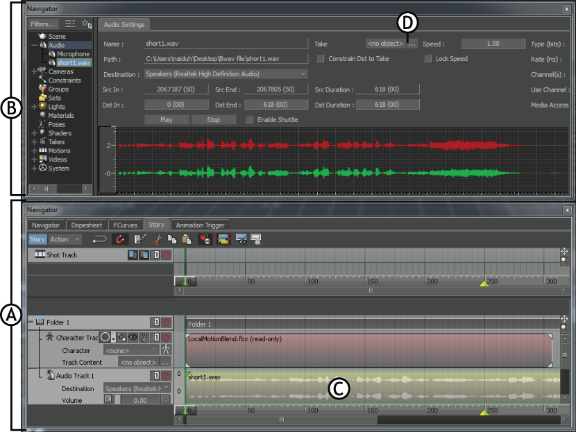

A second Navigator window appears.
Two Navigator windows A. First Navigator window B. Second Navigator window C. Dragged and dropped audio clip D. Take name disappears after assigning the clip to the track
