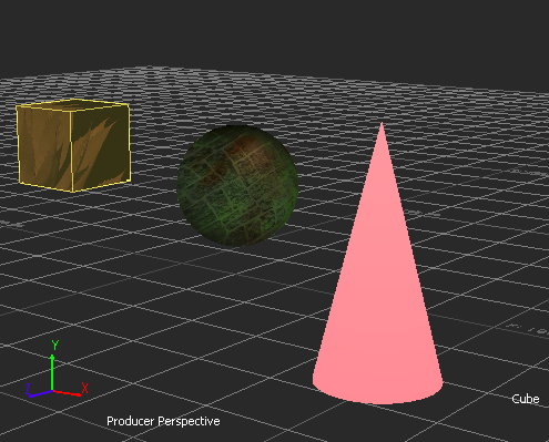

The cursor changes to a 2D cursor (
The object highlights.

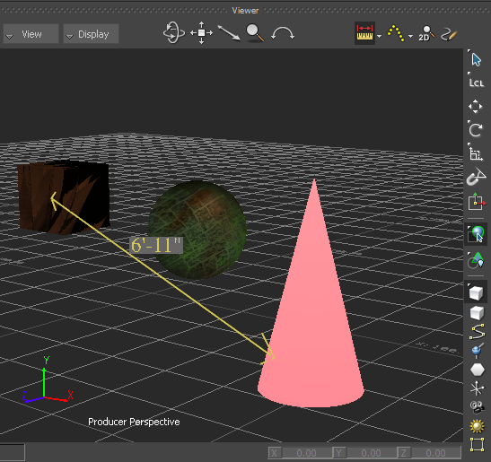

The measuring distance displays and updates dynamically as you start to move the cursor.
The system Ruler "object" is created and displays the distance between the two objects.
Ruler "object" displaying the distance between two objects

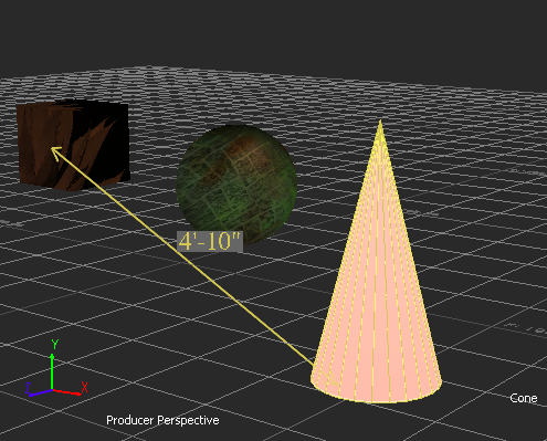

To edit the distance between two objects:
) (or press
T).
The system Ruler "object" remains snapped to the objects and the distance between the two objects updates dynamically.

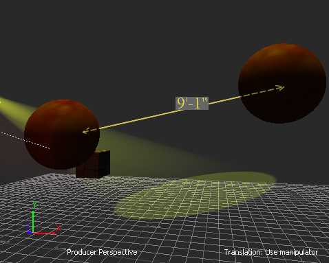

The system Ruler "object" is shown as a dashed line when it is occluded, as seen in the following figure.
Ruler shown partially occluded
